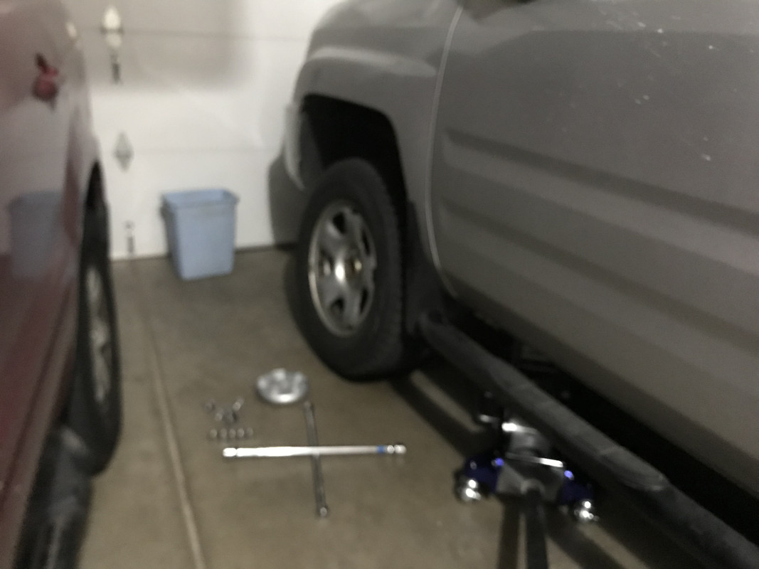

    dodint posted his van with summer and winter tires and wheels recently. I figured I'd do the same here in the Honda thread now that I've finally got it properly set up for ski trips and whatever other trouble I can get into.
    I bought a set of Bridgestone Blizzak tires for the Ridgeline just before we got thirty inches (76 cm) of snow last weekend. Two days later I was in the mountains with the family and glad to have them on snow-packed roads. Today is more snow and we'll get more mid-week and again this weekend, they're saying. March is our snowiest month and this one is living up to expectations.
    With my last car, an Accord, I paid the tire store to swap tires for me twice a year. I bought the car when it was nine years old and figured I wouldn't keep it long enough to justify the cost of a second set of wheels. Eleven years later, I got the Ridgeline and was determined to do it right this time. Last winter the snow never seemed to fall enough when it would have affected my travels, so I put off buying them until this year.
    I bought a 3-ton floor jack, too. Harbor Freight had rubber wheel chocks on sale also, as if they knew I was coming. Nice. What's not so nice is my iPhone 7 Plus has started taking blurry pictures. Oy, that's gonna cost me, I'm sure...
    I bought the wheels on craigslist and the center caps online. It turns out the lug nuts that hold the center caps in place are different than the ones for the aluminum wheels, so I had to buy twenty of them from the local Honda dealer. They had them for me the next day and didn't ask for me to pay in advance, which seemed like a flashback to a nicer time in the world.

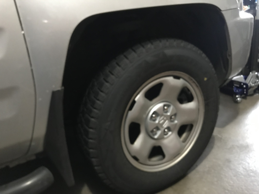

    Suddenly my $40 (for all four) used wheels are more expensive than I had planned, but still cheaper than buying generic black steelies from the tire store. I did the Honda fanboy thing and pointed the bottom of the H toward the valve stems, but you can't really tell in this blurry photo.
    I took this picture this morning after I dropped the kids off at school. I used a camera, not my blurry iPhone.
