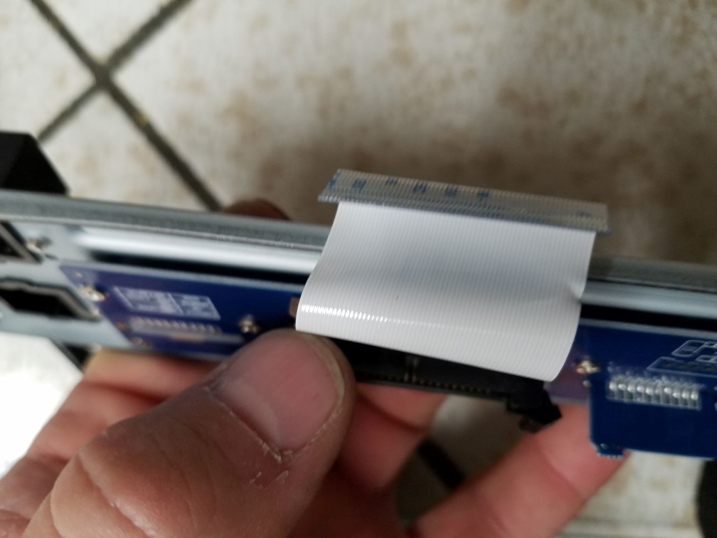

    This afternoon I decided to take apart the head unit, and found a tiny cable is likely the issue with the display. The mainboard connects to a daughterboard with a small, delicate cable that has obvious physical damage. Messing with this cable alternately scrambles and unscrambles the display. I tried flattening it and reinstalling it, but no dice - little jolts scramble the display. I now understand the previous and apparently random problems, so that's progress. I was able to adjust it so that I could do a firmware update hoping to restore the antenna function but no dice. Still no antenna. Everything else works great, though. Being the contingency thinker I am, I am trying to decide whether I'd be okay with a new cable and a discount in exchange for a non-functioning antenna trigger. I could use the amp trigger - all I lose is the ability to lower the antenna when not listening to the radio. It's not world-ending - lots of stereos are like that.

    The little damaged cable that I suspect is responsible for the display issues:

    After some further troubleshooting with Joying, we established there was a definite problem with that little while cable, and there was a problem with the voltage regulator that triggers the antenna. I boxed up the head unit and sent it back to China. Added $40 to my bill, which sucked, but at least it wasn't a battle to get a return.
