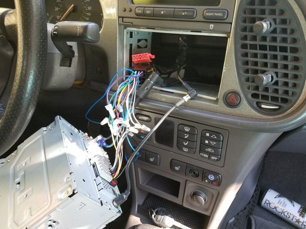

    Anyway, I had all the right parts in the garage, so I made up an adapter to connect a regular stereo to the Viggen's proprietary amp and temp-wired an ISO radio harness to a spare Pioneer stereo to be sure I could easily make an aftermarket stereo work in the Viggen.
    Yep, that works.
    At least I know the wiring won't be a challenge. The challenge will be making it fit right.

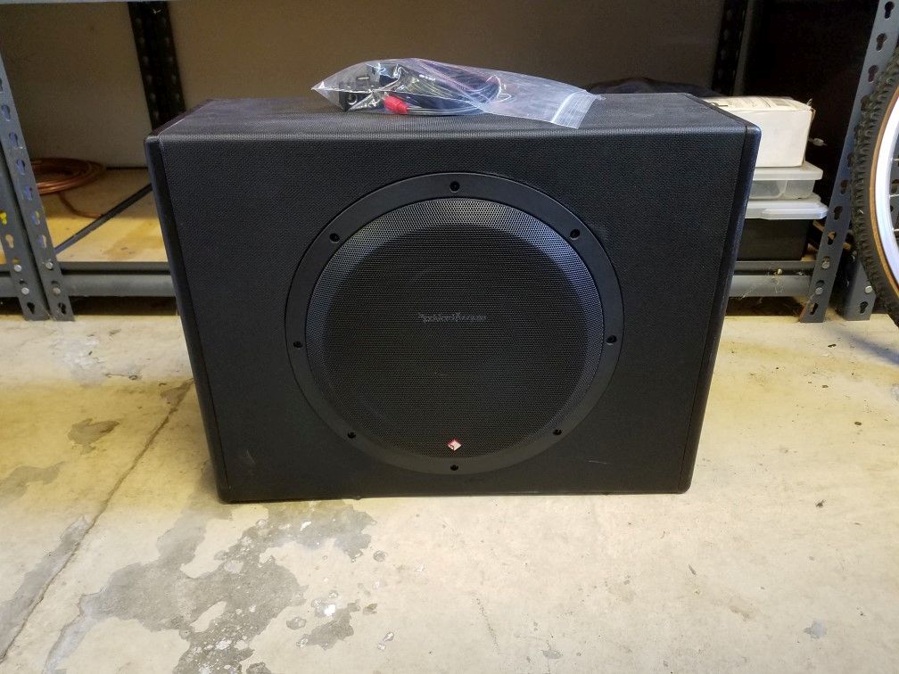

    Unrelated, I yanked the subwoofer out of the parts 9-3 just to clear room in the trunk for actual junk.
    It's almost new. I'm really torn on whether I should keep it or sell it. It's one of those things I will almost certainly never use - I can't imagine being willing to give up trunk space to that monstrosity - but OTOH I won't get much for it, and if I ever do want a 12" sub... IDK.

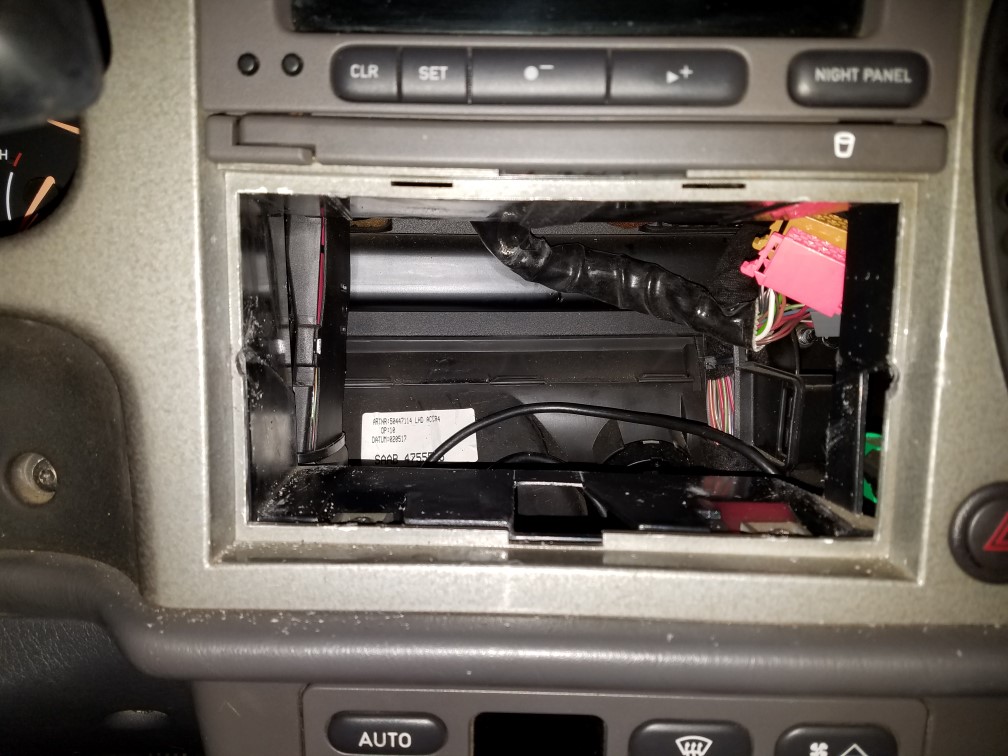

    I think this is going to work out great:
    99% sure my mounting solution will work without issue. The stereo includes an ISO-compatible wiring harness so is 90% plug & play - I just need to make an adapter to intercept the steering wheel controls. Only real things to do are figure out how (or if!) I want to actually block the space behind the display, and how best to make trim to fill in the space between the dash and the display. Those two things can be done after the actual install, so I can hopefully enjoy it for a while and make sure it fits my needs before investing time in custom details.

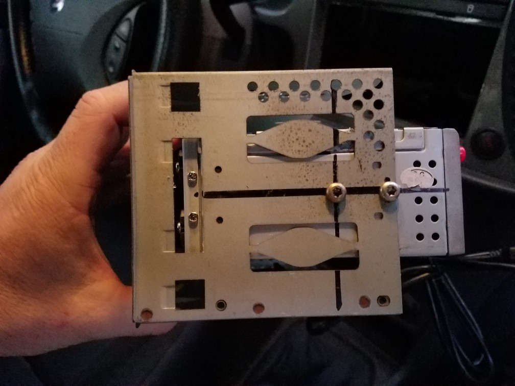

    Factory cage lightly modified so that the 1-din Joying can be secured. I actually junkyarded this cage since I wasn't sure how this was going to go. Clearly wasn't necessary - I could have done this on the one in the car and still used it with the factory stereo.
    Two little half-moons in the dash to clear the screws in the cage. I probably could have found some nicer button-head screws, but I used what I had. You can't see this adjustment with the stereo installed.
    Cage and head unit chassis test-installed. No wiring is done, but proof of concept.

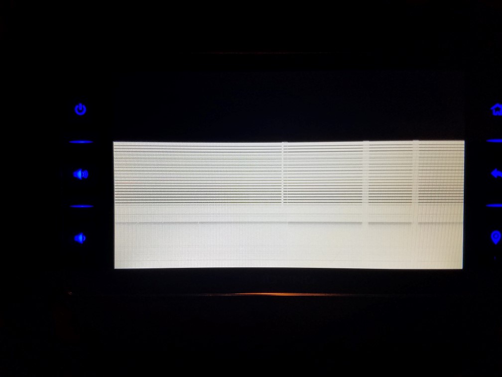

    Total panic.
    After three reboots the head unit fixed itself. Coincidentally, this is exactly what my clone Tech 2 did the first time I booted it up... totally scrambled display! There is a label on the head unit that says in truly broken English "After reattaching the display press the reset button" so I did that. It was less scrambled the second time, so I did it again. Looked better, so I did it one more time. Third time's the charm!
    I cycled the ignition a few times and it's stayed intact, so I think it's good. In doing so, I noticed the thing loses about half its settings every time the key is switched off and back on. I changed about a half dozen things, they get lost when I turn it off.
