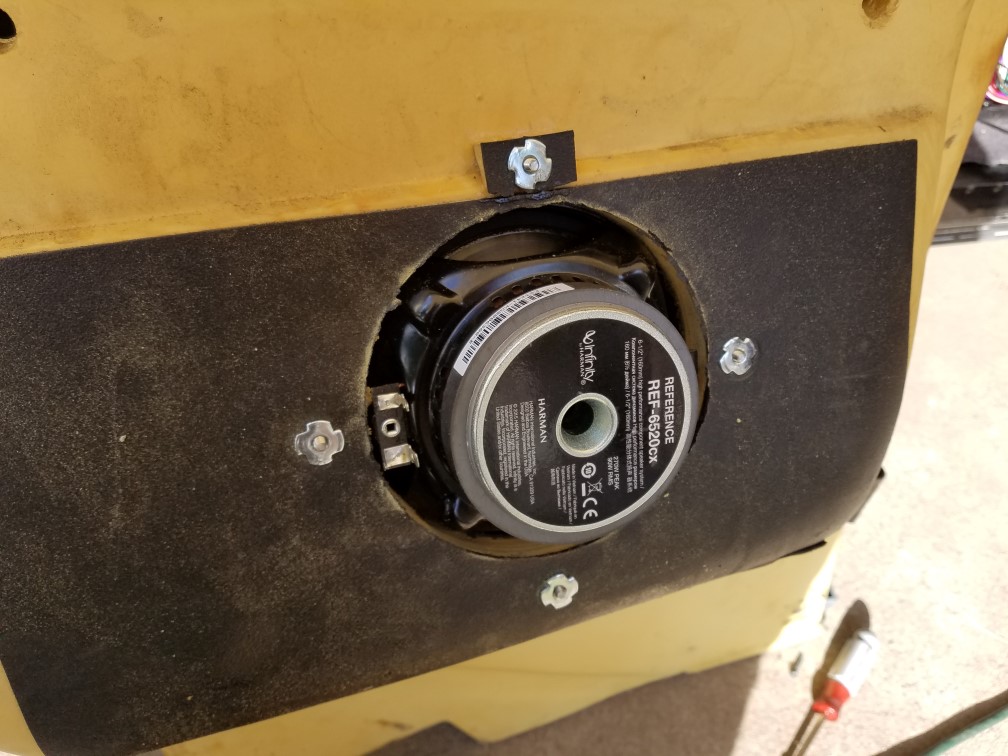

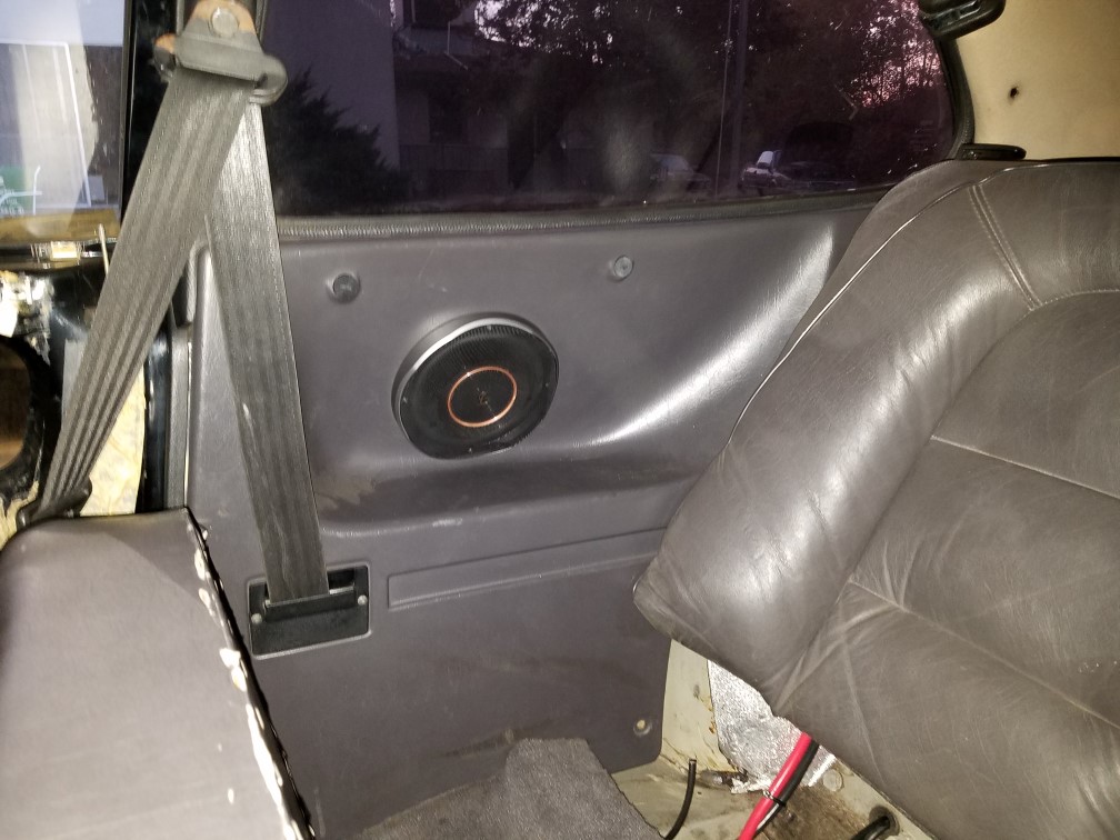

    I didn't want to end the weekend on a low note, so I spent some time on the SPG, getting more wiring done. The dog's surgery jacked up my rhythm and I've found it hard to get it back. When things are fresh in your head you can get back to them day after day, but take a month off and it's a big hurdle to remember where you were and what you were doing. But, I spent 12 hours on the SPG yesterday and I feel like I'm on track there.
    The factory set up is a pair of 4x10s in the rear deck. It's a crap speaker size and a crap location. The first 900 (and 99s before them) had little 4" Philips speakers in the rear side panels, and I've seen & done similar on other 900s since. What I ran into here in 2017 was totally unexpected: Nobody makes a shallow 4" or 5.25" speaker with a grille anymore. WTF? "No grilles included" was becoming really annoying. So, I hit up a junkyard a couple weeks ago and sliced up a car real bad, real real bad, so I could take some measurements and determined exactly what I was working with.
    What I found was that I could clear 6.5" speakers with a 2" depth.
    TBH, I'm not super pleased with how crowded that looks, but a) choices were limited, b) I don't have to sit back there (actually, nobody can - no seatbelts), and c) I couldn't continue with 4x10s. It'll do. Nicely, the speaker that fit 6.5"/2" depth/with grilles were Infinity Reference 6520CX components, which are exactly the same speakers I'm using in the front. I'm actually kinda stoked about that. Both are connected to that "mini" Kenwood KAC-M1804 amp, so I should have some good sound. Eventually. I think I'm calling off the front door project for now - it's a buttload of fabrication and I'm not prepared for it.
    Installing these speakers went great. I learned a lot about hardware since the last time I tried this. I ordered some M4 tee nuts and button-head M4x30mm screws from McMcMaster-Carr, which resulted in a super-clean, super-sturdy mounting. I had to get creative with the top screw using scrap from the cutouts, but it worked great. This will be the first time I've done this install where I can actually remove the speakers from the panels without cursing. All the other installs were really clumsy.

    Why did you install the Infinity speakers sideways?
  8. #438
    To make enough room to clear the speaker cables without straining them.

    <-- I was kidding.
  10. #440
    No, it's a legit question and I'm annoyed that Infinity created grilles that support limited installation orientations. It's pointless and short sighted. But, we make do... although it's gonna bug me a bit for a while.
