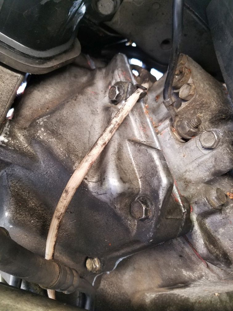

    The maiden voyage of the $760 9-3 did not go terribly well. It started off really strong - 12 miles of zero issues, everything doing exactly what it should and being actually quite pleasant to drive. I got cocky and decided to give it a little boot merging onto the freeway and got a Check Gearbox fault and no 4th gear. I drove it eight miles home limited to 3rd (which is fine for surface streets) and went looking for problems, pretending like I know a damned thing about automatic transmissions. Please. I did find these:
    That's the connector for the coolant level sensor (so that's why the warning is always on) and the ground for the transmission temperature sensor. It seems like this car had spiders and mice. I fixed them, found no other damage, changed the transmission fluid a second time, and then had the exact same problem again, reaffirming the fact I don't know a damned thing about automatic transmissions.

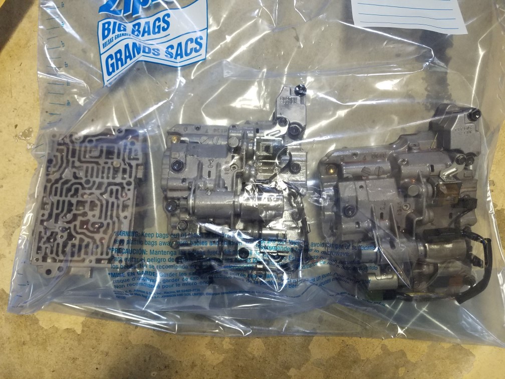

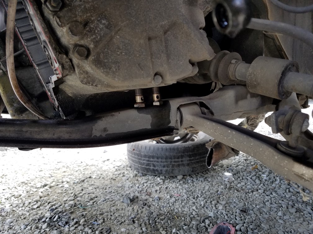

    There was one '00 and one '02 9-3 at the junkyard, both automatics, so I headed over there and grabbed both of their valve bodies because why not. It was not so difficult - in all seriousness the worst part was the upper bolt on the transmission mount bracket, as it's covered by an AC tube. Getting a wrench in there was very problematic - literally the most difficult part of the operation. Everything else was smooth - a couple dozen easy bolts. I was not particularly proud of this:

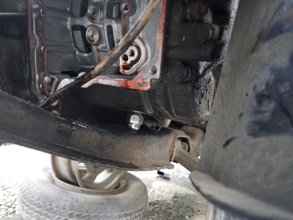

    But it worked. Yes, that's a lug nut and two banjo bolts keeping the transmission off the subframe. I just wedged them in there before removing the transmission mount and nothing bad happened.
    I hope I didn't ruin someone's life, but I just cut the entire harness off the inside of the transmission. That plastic seemed really fragile and I did not want to mess with it without a clear view and good access. So, those things are useless now. Both valve bodies took less than two hours not a big deal at all.

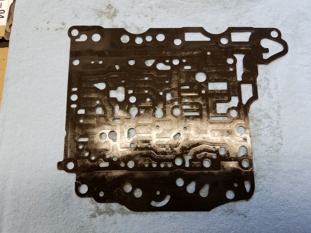

    Then I totally screwed the pooch. Somehow while being handled - between the yard and my house - I wrecked BOTH lower gaskets in exactly the same place. I didn't notice they were there, and then it was too late. FML.

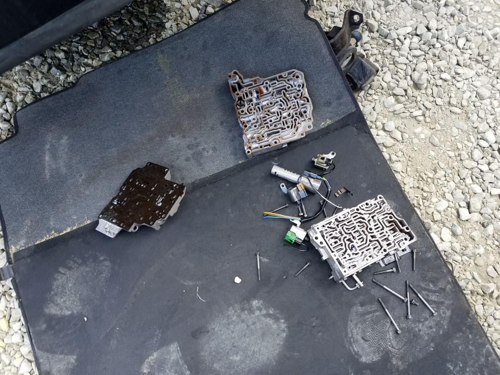

    When I found the damage I decided to make it worse by dismantling one of the valve bodies. What was there to lose? That got me to here:
    I called all the major local transmission supply warehouses and nobody sells a replacement gasket set. Then I dug through all the manuals I downloaded and found no part number, or even a kit which includes these gaskets. FAIL.
    That left me with needing to salvaging the gasket from the valve body that's coming out of my car. Back in the '90s I did this more than once with the terrible automatics in the early 9000s (4HP18, IIRC) and I didn't even have any service manuals for them. What's nice about this transmission is that there are intermediate plates between each part of the valve body so there is far less risk of losing a check ball or filter, but it's still a bit nervewracking.

    Before I started on my replacement operation, I got The Fear so I went back to the junkyard to remove yet another valve body to salvage a gasket. Better safe than sorry, and I'm getting really good at it. Check out my sexy transmission mount... 2nd generation, totally refined:
    Took the thing apart in the junkyard...
    All I needed was this gasket, so paying for a whole additional valve body seemed silly.

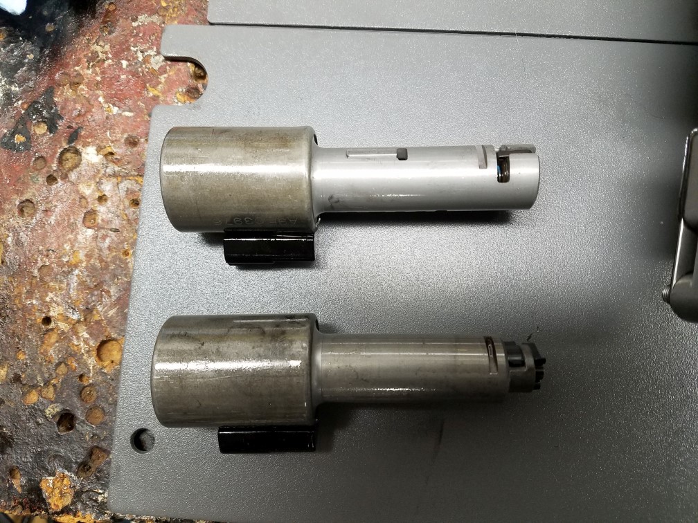

    Some interesting details.... the '99 valve body and '00 is different from the '01+. These are the two versions of the pressure solenoid:
    And these are the two versions of the S2 shift solenoid:
    I don't know if there is a functional difference, but I didn't want to chance it. My '01 was the same as the '02 part I junkyarded, so I left the '00 one on the bench and got to it.
    Getting the valve body out was not difficult (obviously, I had so much practice) and getting it back in was a little nerve wracking as I didn't want to damage the rearmost gasket, but really not difficult. I was nervous about fitting the cover in without tagging anything with wet sealant, so I practiced putting it in place several times before actually going for it. My work probably would have been easier had I removed the downpipe, but I didn't. As a result, I had to go in through the side. Since none of the underbelly plastic was in place that was a convenient approach. The key here was unbolting the forward subframe bolt and instelling a 1/2" spacer between it and the body. With that tiny extra space, getting the cover in was not a problem.
