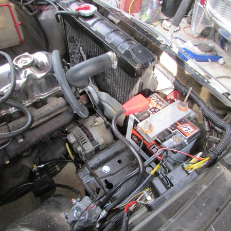

    The battery looks like about the same dimensions as the Braille in the Falcon. This is how I secured it:
    It's a piece of rectangular tube aluminum. I cut out a notch in the underside to give the battery lateral support, leaving enough of the vertical wall (like 1/8") to reinforce the bridge across the battery. I used parts of an Autozone battery hold down kit to secure it to the Falcon's tray. I was able to use one end of the tray's existing hold down hole, so the only modification to the tray was a 3/8" hole drilled in the middle for the other side. It would have been easier to use a hole saw and make a 1" hole, but I didn't want that much "damage." End result is that the hold down has to be inserted at an angle and then tilted up. Not a big deal.
    I know you know this, but that battery ground situation is hella jenky. I'm sure it'll be fine for a little while, but I would address that sooner rather than later. You can buy battery cable eyelets at Napa (maybe other places, but I don't think Autozone), and I think a few places rent low-end battery terminal crimpers. You could buy that 12" bit, cut the end off, and recrimp it to a new length. Alternatively, sometime this month I am going to buy a real battery crimper (like a $250 Quickcable crimper). If you tell me what you need and don't mind paying for the supplies (I'm guessing $4-$8 ) I'm happy to knock out a custom battery cable for you.
    Edit: I have 10' of that tube aluminum. If you want to go that route, I'm happy to cut one for you. I will never use 10' of giant rectangle tube aluminum. Too late to help you for this weekend, though.
